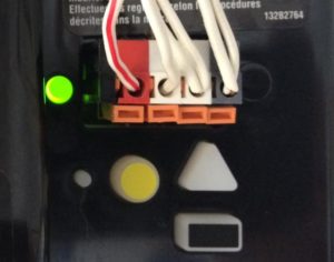

Most of the garage door openers support a simple wall button operation. Connect Garadget’s wires to the same terminals as the existing wall console.
You can determine the connection for the wall console by tracing the wires visually or by checking the installation instruction for your specific model of the garage opener. If you need help, please check out the examples in our community board or contact us directly.
