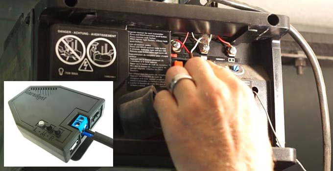

Controller Wiring
Majority of garage door openers can be operated from inside of the house using a wired wall console. Garadget acts as a computer-controlled push button and its blue terminal should be wired to the same two contacts on the opener used for the wall console.
You can determine the connection by tracing the wall console wires visually or by checking the installation instruction for your specific model of the garage opener. If you need help, please check out the examples in our community board or contact us directly.
Use the included screwdriver to loosen both screws in the blue terminal on the back of the Garadget without completely removing them. Push the stripped ends of the included controller wire under the tabs of the terminals then tighten the both screws. The polarity of this connection is not important.
The other end of the control wire connects to the terminals of the garage door opener according to your research. If the length of the included wire is not sufficient, you can use 18/2 solid thermostat wire from home improvement store or pretty much any other type of wire you can source around the house.
